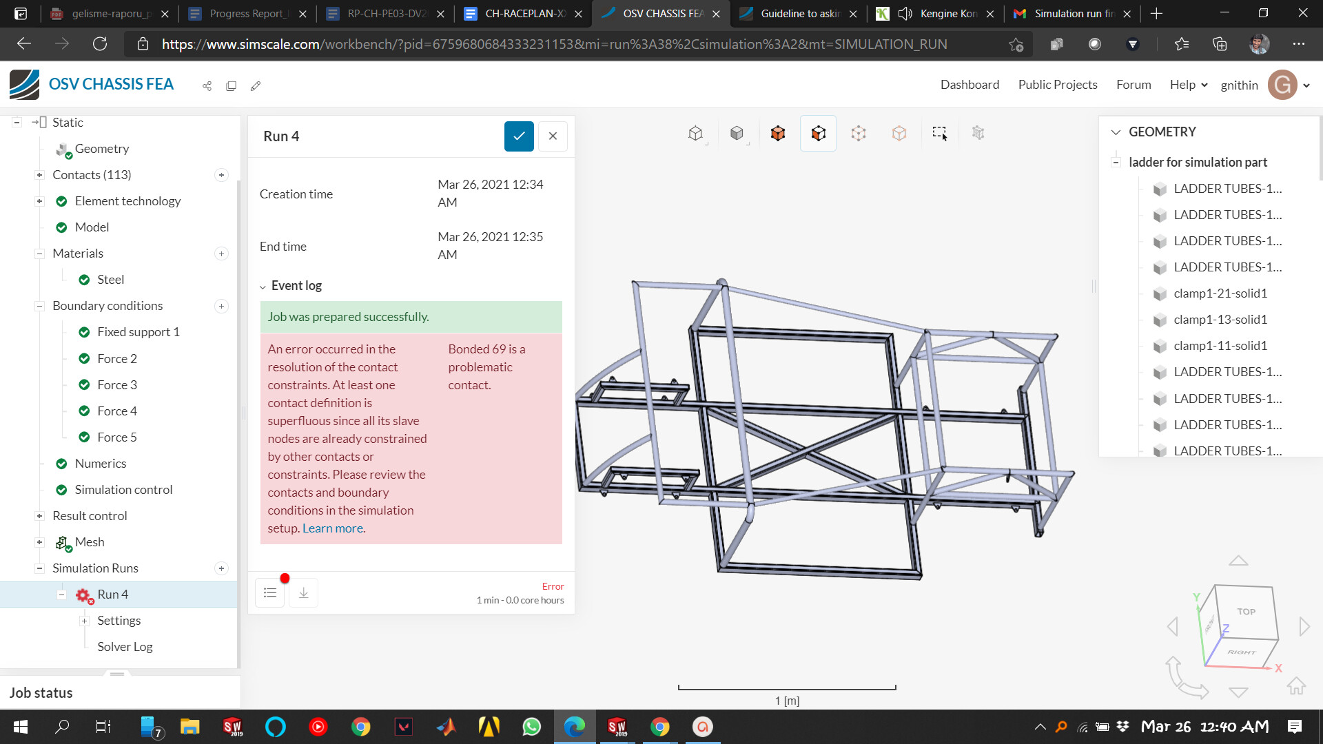

Hi , Thanking you in advance.

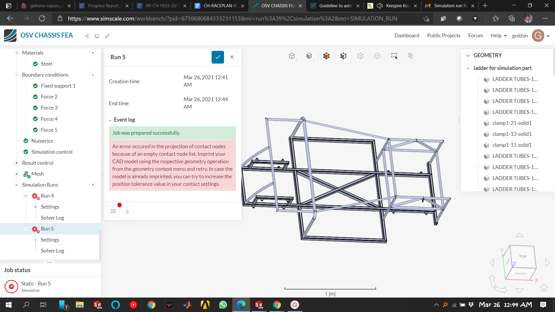

I m getting this 2 errors every time i m dng my sim
ulation run. Please letme know what can be done.
OSV CHASSIS FEA | SimScale Workbench

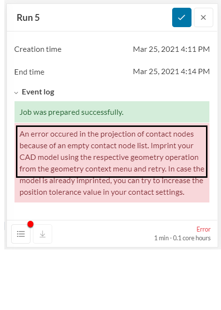

The error messages already hint the solution. By following the instructions, you should achieve a successful simulation. For instance, here is what we have from the error message in the latest simulation run:

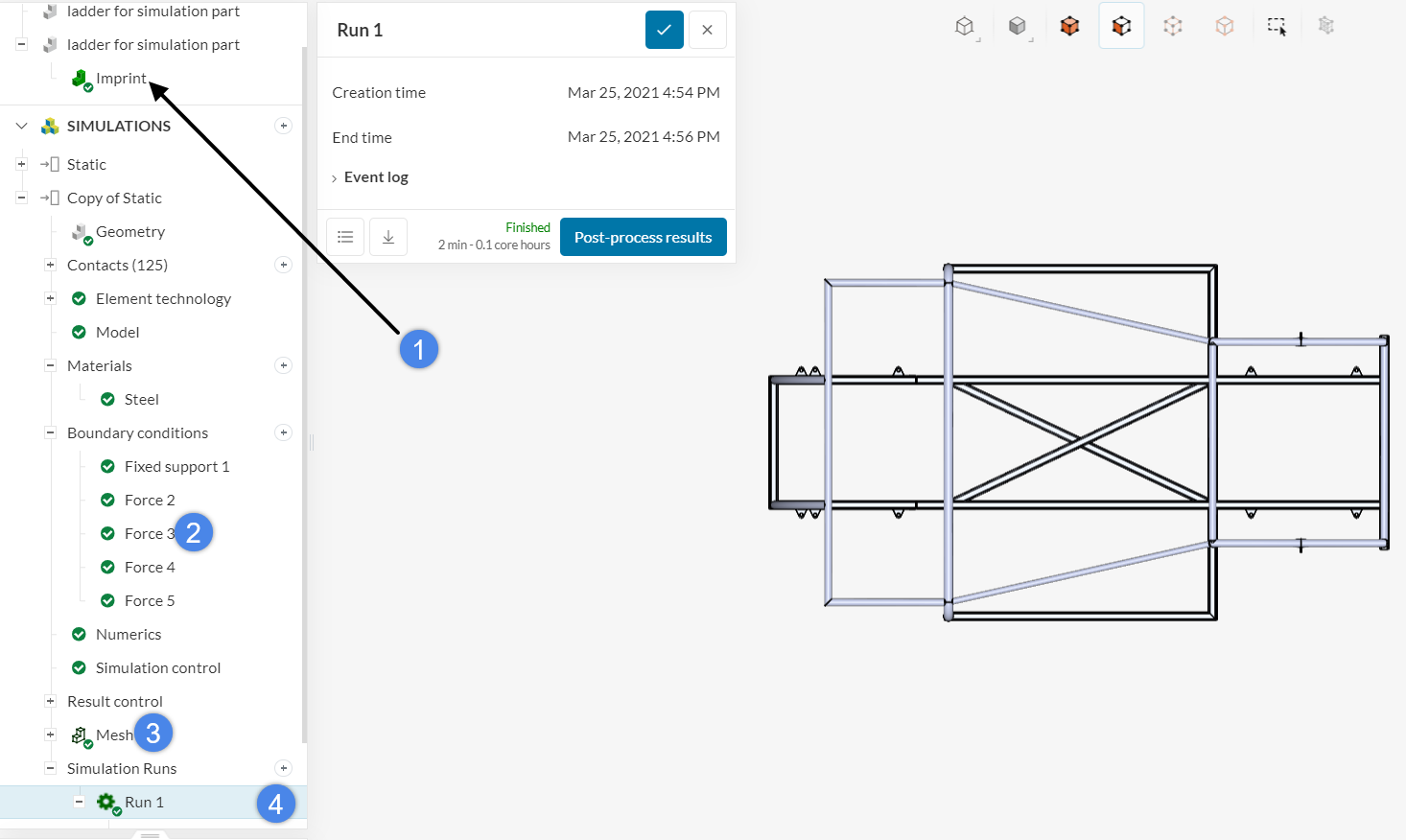

By following the hint from the error message, you can simply run an imprint operation on the geometry and use it for a simulation. The run will be successful.
