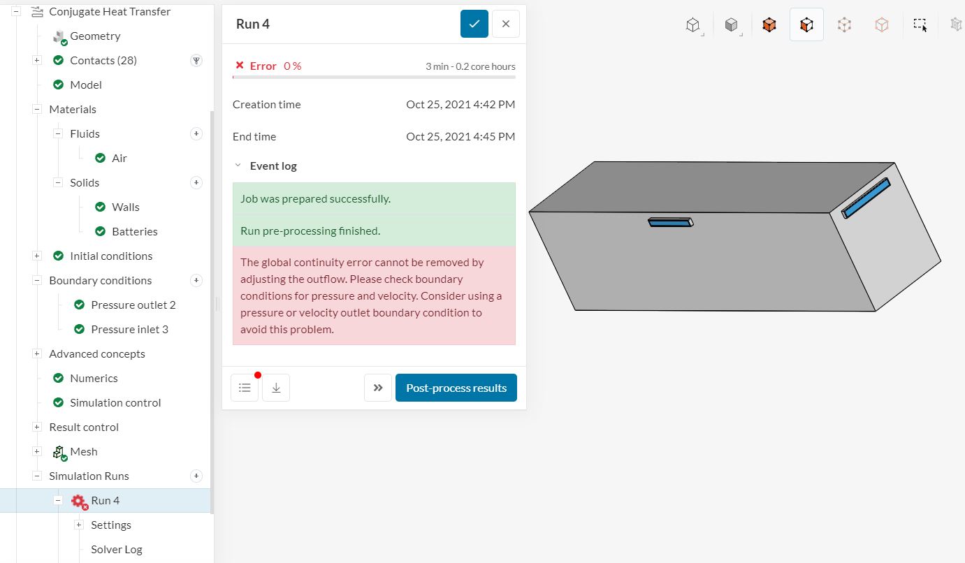

I was trying to simulate three ceiling mounted Aircons in a enclosure. But it was not supporting so I simplified my design to atleast run the simulation successfully. Enclosure | SimScale Workbench
Now I have one inlet and one outlet of air but still getting error on the simulation run. Kindly advise me about it.
It seems like you have figured out how the boundary conditions work. The global continuity error appears when there is a imbalance in the law of conservation of mass in the oulet and inlet flows. Here is an article about that: Error: Continuity Error Encountered Cannot be Removed | SimScale
Please feel free to reach out in case of further question.
