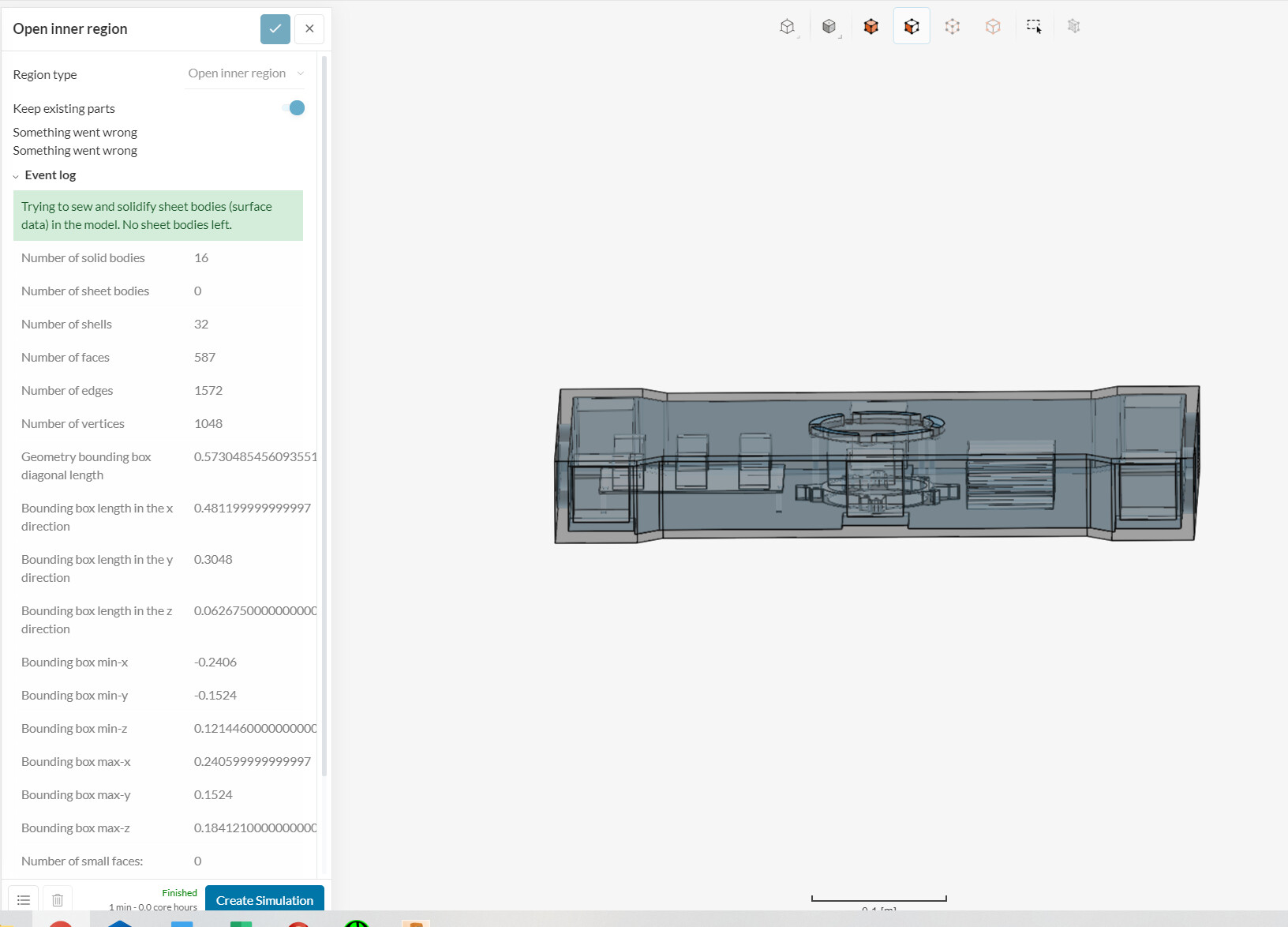

I am trying to run a simulation using Conjugate heat transfer and when I go to generate my mesh it says “The physics can not be taken into account as the simulation setup is not valid…”, I believe it is caused by the following message I am getting when I try to create my flow region.
It says it is trying to sew and solidify sheet bodies but my CAD model does not have any as can be seen in the image. I have looked around but couldn’t find this issue already posted in the forum.
A little background on the situation, this is my second attempt at this simulation, my model was not simplified enough so I had issues running the simulation but was about to create a mesh so I don’t think the issue is in my simulation set up. This is not an issue I had last time which leads me to believe it is the cause of the “invalid simulation setup”
The link to my project is https://www.simscale.com/workbench/?pid=2839096624495565266&mi=spec%3Adb165d23-6ae9-4d48-91ba-14b1acb29b7d%2Cservice%3AMESHING%2Cstrategy%3A176&sh=175 if you want to have a look.
I am very grateful for any input/ help available.
Thank you,
Steven!

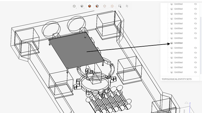

The issues are in fact related to the setup:
  • One volume doesn’t have a material assigned to it:

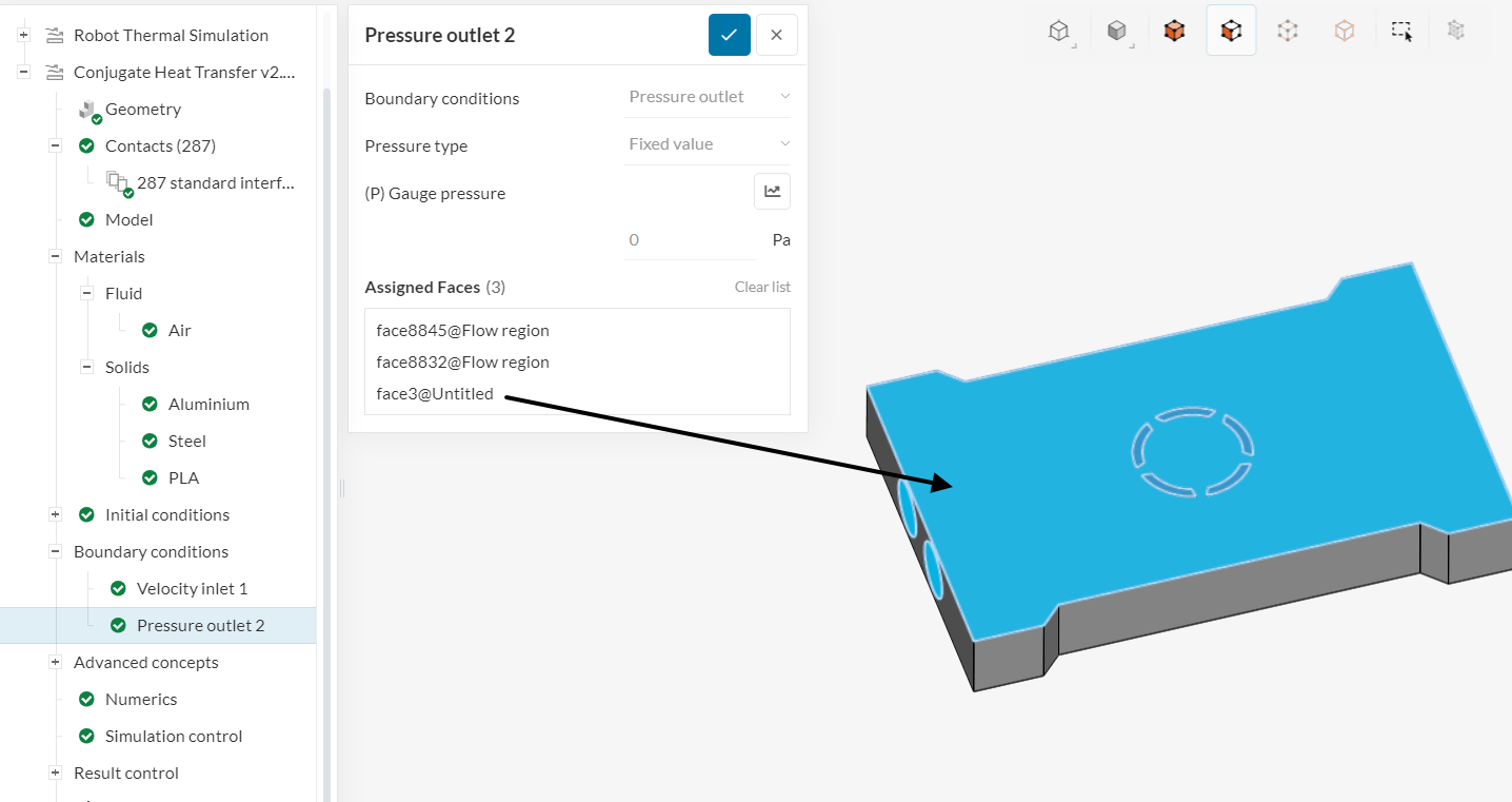

  • The pressure outlet BC is assigned to a solid, which is not valid:
After fixing these two pointers, the mesh should run.
