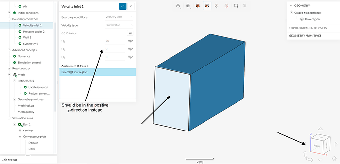

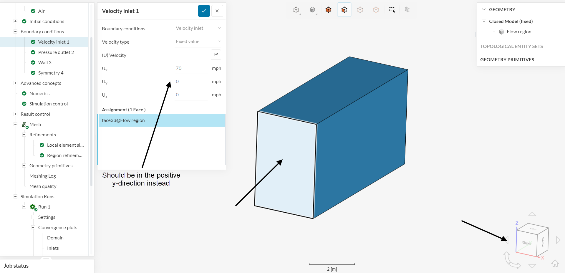

- The velocity inlet is pointing in the wrong direction (notice the orientation cube in the bottom right corner):
 ![image](https://www.simscale.com/forum/uploads/default/original/3X/0/d/0de5c6ce925da1c0dcc009df3f635f6d8844f83d.png)

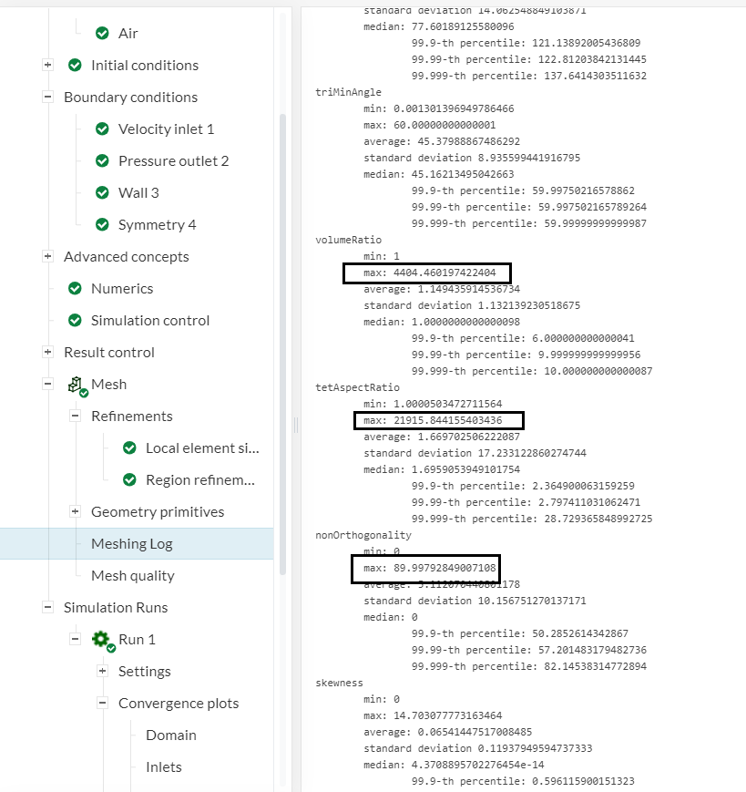

- The mesh quality metrics could definitely be better. Please find more notes and usual troubleshooting practices in this [article](https://www.simscale.com/knowledge-base/how-to-check-and-improve-mesh-quality/):
 ![image](https://www.simscale.com/forum/uploads/default/original/3X/b/7/b75defcd2c0b6d08609fce1bde362b01f26b9193.png)

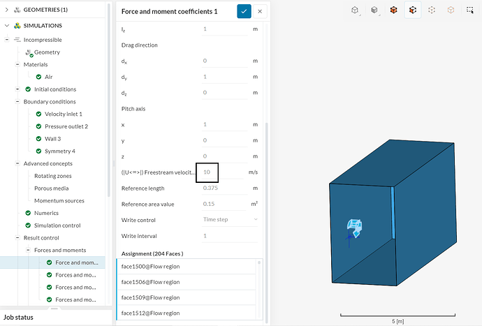

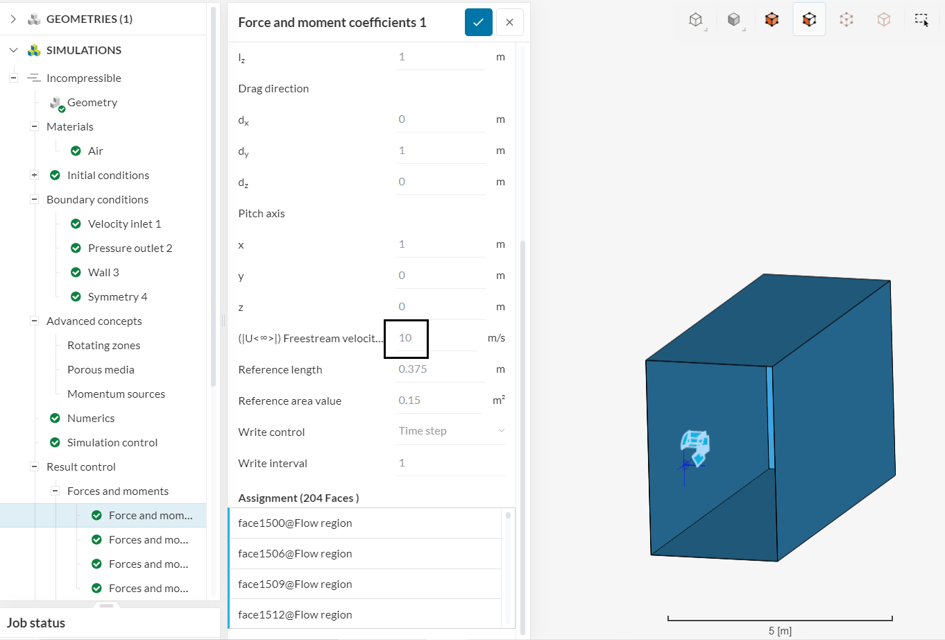

- The freestream velocity for the coefficients is also different from the inlet velocity. Learn how this will negatively affect the coefficient results [here](https://www.simscale.com/knowledge-base/why-are-my-lift-and-drag-coefficients-too-big-small/).
 ![image](https://www.simscale.com/forum/uploads/default/original/3X/b/3/b3ab3d24e3fd17cad7c31a96fa3a148d715da3e4.png)
