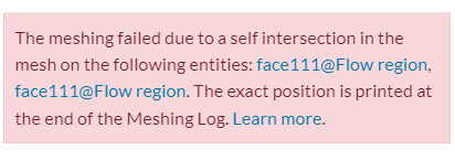

I fix that one, but now I can’t mesh because of this error.
Immagine 2023-05-26 134113
But if I go in edit cad mode, no interferences are detected.
Hi again @Raffreddore,
I see that you still have a solid body there. So please delete that from your volume extraction as shown below. I also see there is no error message so please do not delete if something wrong occurs again to give me the chance to take a close look :slight_smile:
Try that and let us know if it is working now.
best,
Sorry I forgot to tell that I copy your project and change the geometrya bit to resolve the first issue. The project is this one now. And I have the error on the screenshot.
