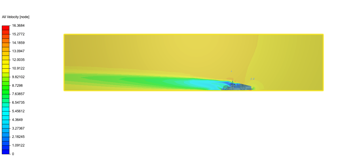

you have all blue but you have to make sure you jump forward in time and pick the right result field. Example:
I was just working with a slice and the velocity where I additionally adapted the range. Let us know if you have any further questions.

Hi @jousefm,
i am still not able to see the pressure. The velocity field is clear. But i have some problem with pressure.
Are you able to see that?
