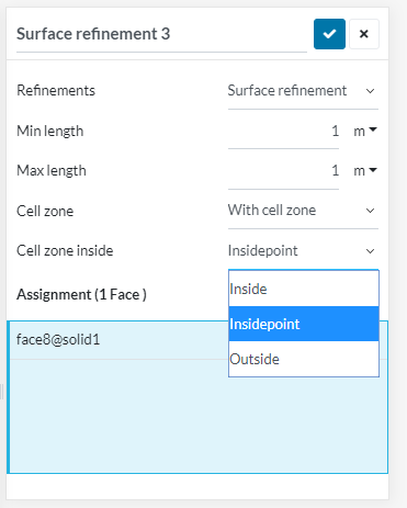

Some time ago we found that we were showing an option in the cell zone UI which didn’t make sense. Here’s a picture of how it used to be:
We decided to remove the options “insidepoint” and “outside” because they didn’t provide any value but rather added confusion and caused errors sometimes.
The corresponding changes had to be done in 2 different services and one of them wasn’t updated accordingly. The result was that the “new style” cell zones weren’t recognized properly anymore and so they wouldn’t appear for you guys anymore.
This problem shouldn’t have occurred in the first place. Unfortunately our automated tests didn’t catch this. Moving forward we’re going look for a way to test this particular type of bug and add more automated tests around cell zones to make sure they don’t break in this particular way anymore.
