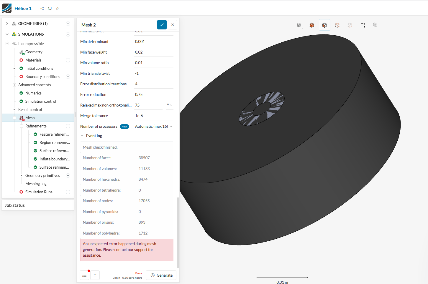

I’m facing a problem with my mesh generation for the simulation of a flew around a propeller.
Can you indicate me how to solve it ?

I think that your model is still not suitable for a propeller simulation. My suggestions are:
  1. Create a flow region around the propeller (exclude the cylinder that will be used to define the rotating region, using the “Excluded Parts” option)
  2. The cylinder must leave a small gap all around the propeller.

Can you detail me where to find the exclude parts option ?
Hi again!
It can be found in the setup panel for the flow region creation.
