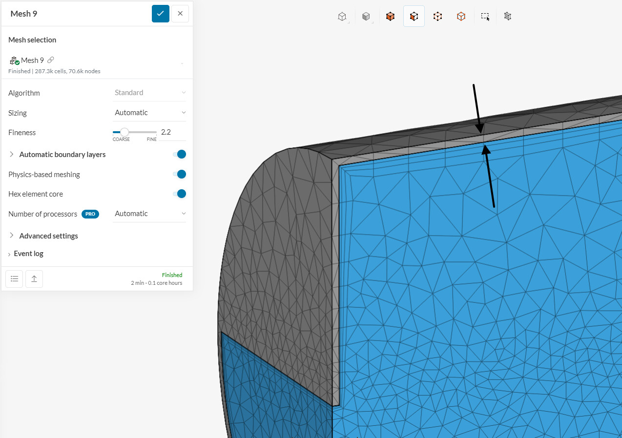

On a side note, from the solver log, it looks like the simulation is diverging very quickly (in 3 iterations). To be fair, with the current model, you can probably even use a convective heat transfer simulation and the result would be almost identical as the CHT runs.
Unless you are interested specifically in the temperature gradients within the walls of the smoker, a convective heat transfer simulation should work fine (I ran a quick test). For a convective heat transfer simulation, you can simply delete the solid wall volume and the rest of the setup is identical as you have it for the CHT project.
PS: if you are interested specifically in the temperature gradients within the wall of the smoker, it’s a good idea to add more cells to the solid. Currently we have less than 1 cell across the thickness.
