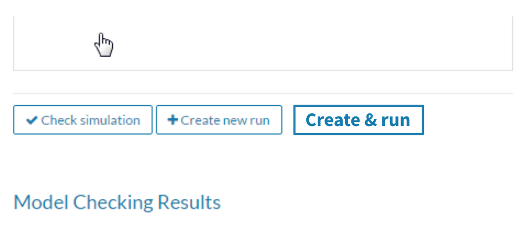

When creating a simulation run there should be an option to “create run and start”. This saves having to come back at a later time to start the run.

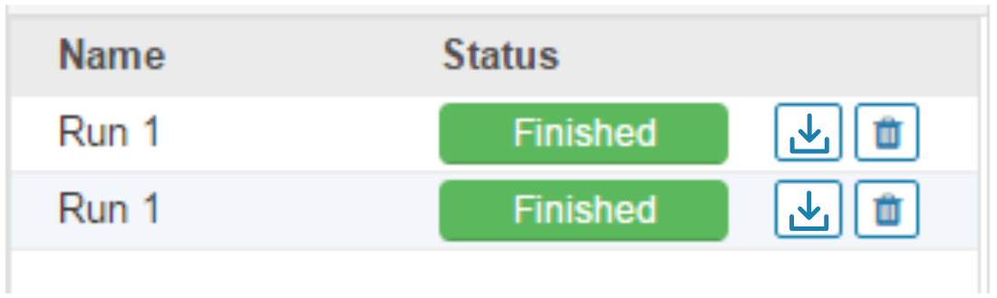

When a simulation is complete the stop symbol in the Job Status window should change to a download symbol. After completion the stop symbol is no longer required. Making the results available for download from the Job Status window saves having to switch context just to download the results.

Great ideas! I just passed them to the engineering team. The first two suggestions seem to be quite easy modifications- I will push them for discussion and implementation.

I’ve discovered something else which may help. Currently, it is possible to drill up and down in the tree, using the (+) and (-) icons without triggering a geometry change. In fact, it possible to drill all the way down to a Simulation Run and download the results file. This is great.
