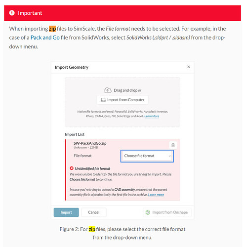

Please have a look at this page about the supported upload / CAD formats.
I read, but still cannot do. I did compressed zip file. But could not uploaded
Hi aburkitbayev,

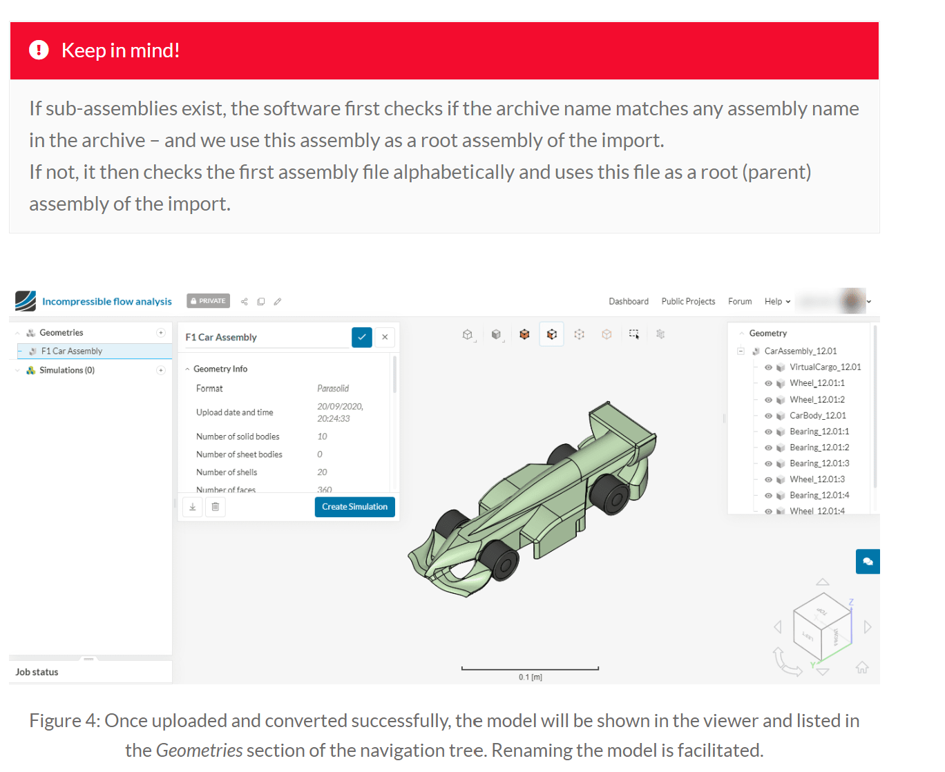

Seems you are using Solid works which should be ok, using the right file format, but if you are importing a zip so I think you know you have to select an acceptable file format to upload it, but maybe its the subassembly that is the underlying issue. But my information is coming from @SBlock link, so the next alternative is to search Simscale documentation. I don’t use Solid works so I can’t provide an exact answer. All the best.
Subassemblies
