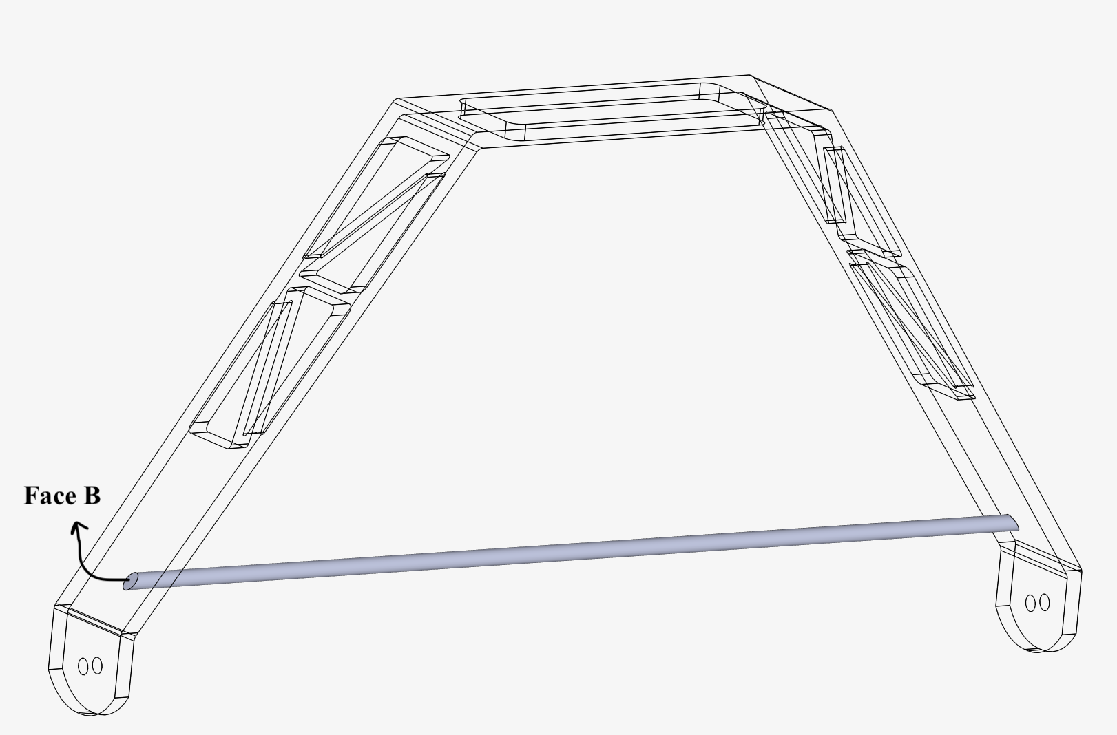

Yes but I am more interested in the volume stresses. I am planning to figure out the reduction in stress in the main landing gear body due to this rod.
Actually I am a newbie to this so any in-depth is appreciated.

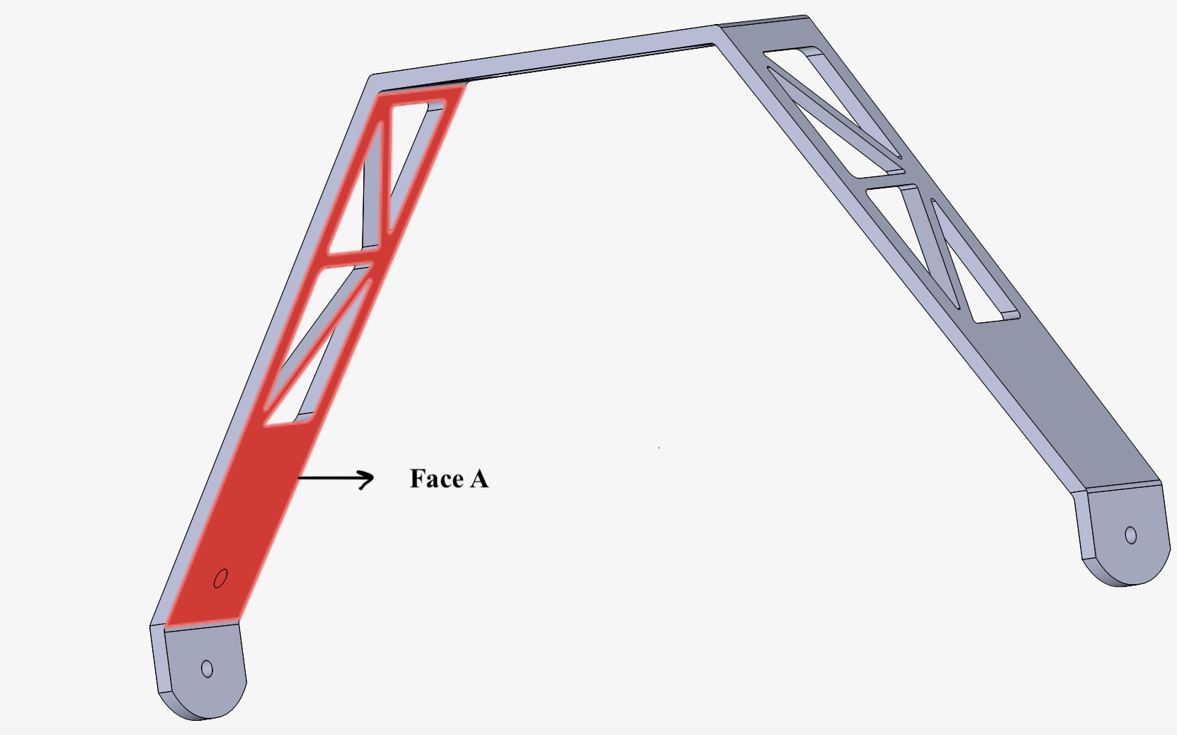

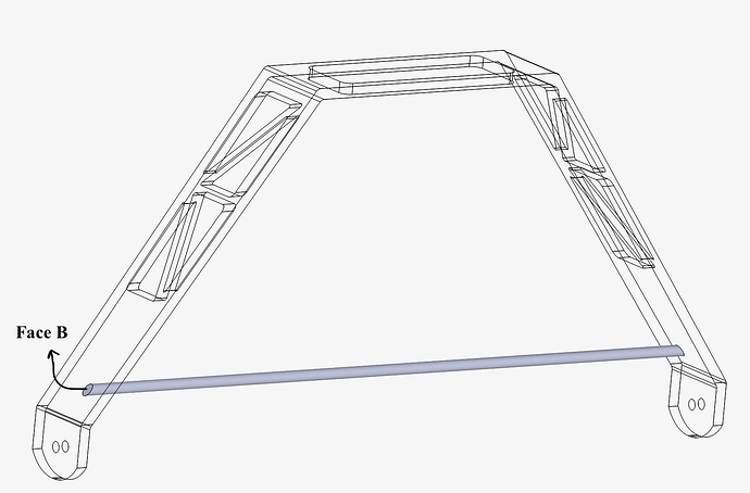

If this is a welded joint I would definitely use bonded contact. You could also simulate the welded area by reducing the contact area if you are interested in local stresses.
If it’s a fastened joint and you are not interested in local stresses, deformation, or relative motion then use Bonded, otherwise you might want to consider Physical contacts.
It will for sure be a welded joint; I’ll try reducing the contact area for sure.

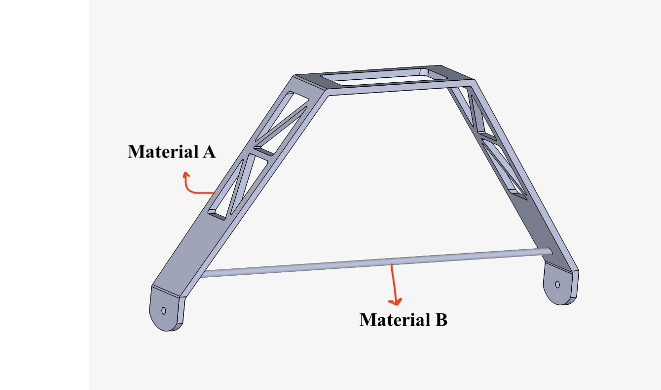

Also if my Material A and B have very different material properties (like Aluminium and Steel) then is it preferred that I do a Static Non-Linear Analysis?
OR
Will a linear static analysis do the job?
P.S: I do not want to analyse the stresses and material characteristics in the plastic or hyperelastic region.
